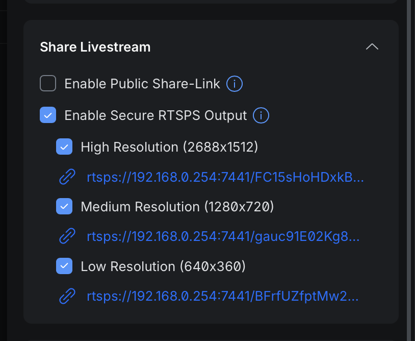

    FYI: you can use Ubiquiti if you have their Protect server running and share the RTSP links from the device settings:
    (this is what I do)
