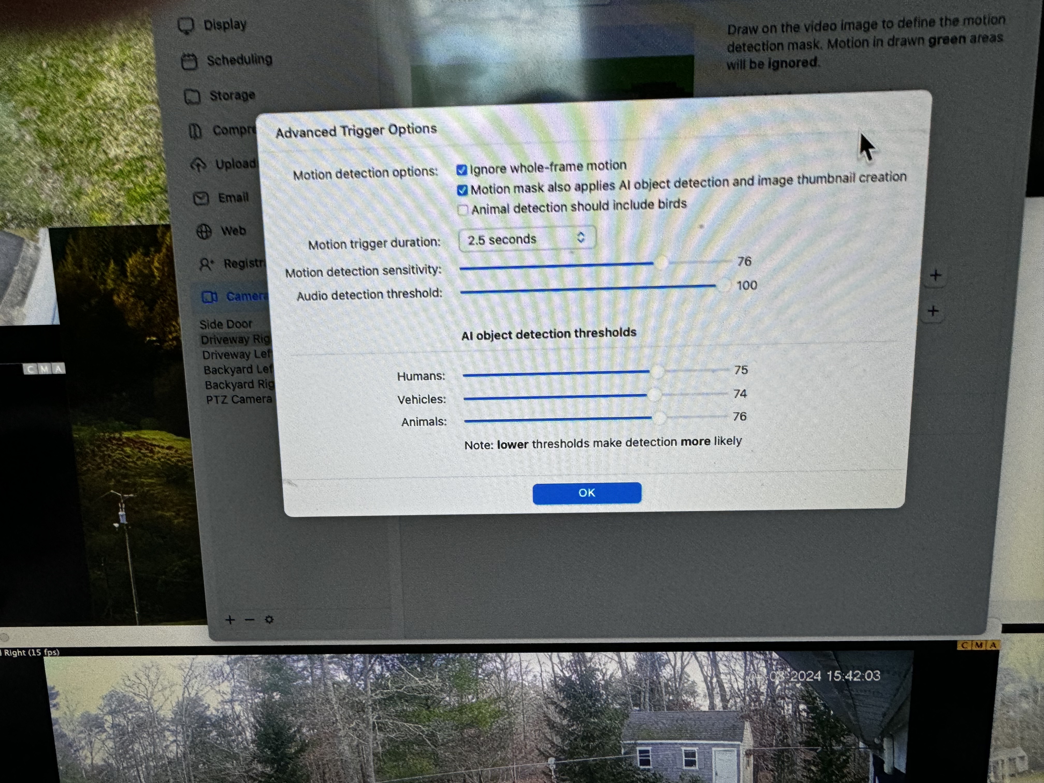

  • I am having the same problem on the new version with all settings bumped up to 75 and set to 2.5 seconds. I tried having groups of cameras with different settings to compare and or isolate. Dialing down the sensitivity to higher numbers helped but not much. Having either the general sensitivity or the target (human, automobile) increased the number of triggers from precipitation
    Rain or mist causes hundreds of emails. Using a current dedicated Mac mini with 6 cameras.
  • Hi @Curtis are you using AI object detection? This is the thing that will cut out most false-positives. If you are already using this, and you're still seeing this problem, please email us and include screenshots to demonstrate your settings, and the kind of false-positives you are getting, and we'll work with you to improve this.
  • SS V6.0 AI is set to 75 along with the general setting.
