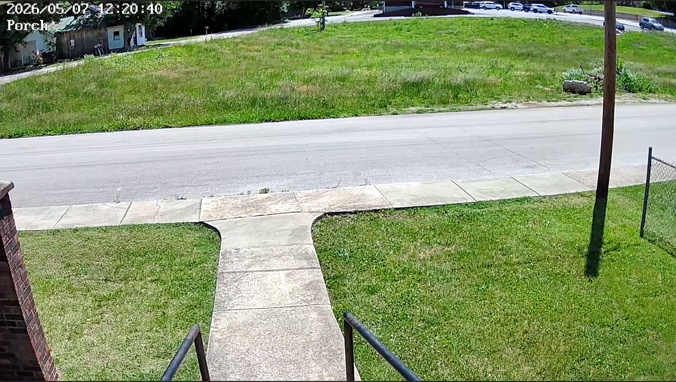

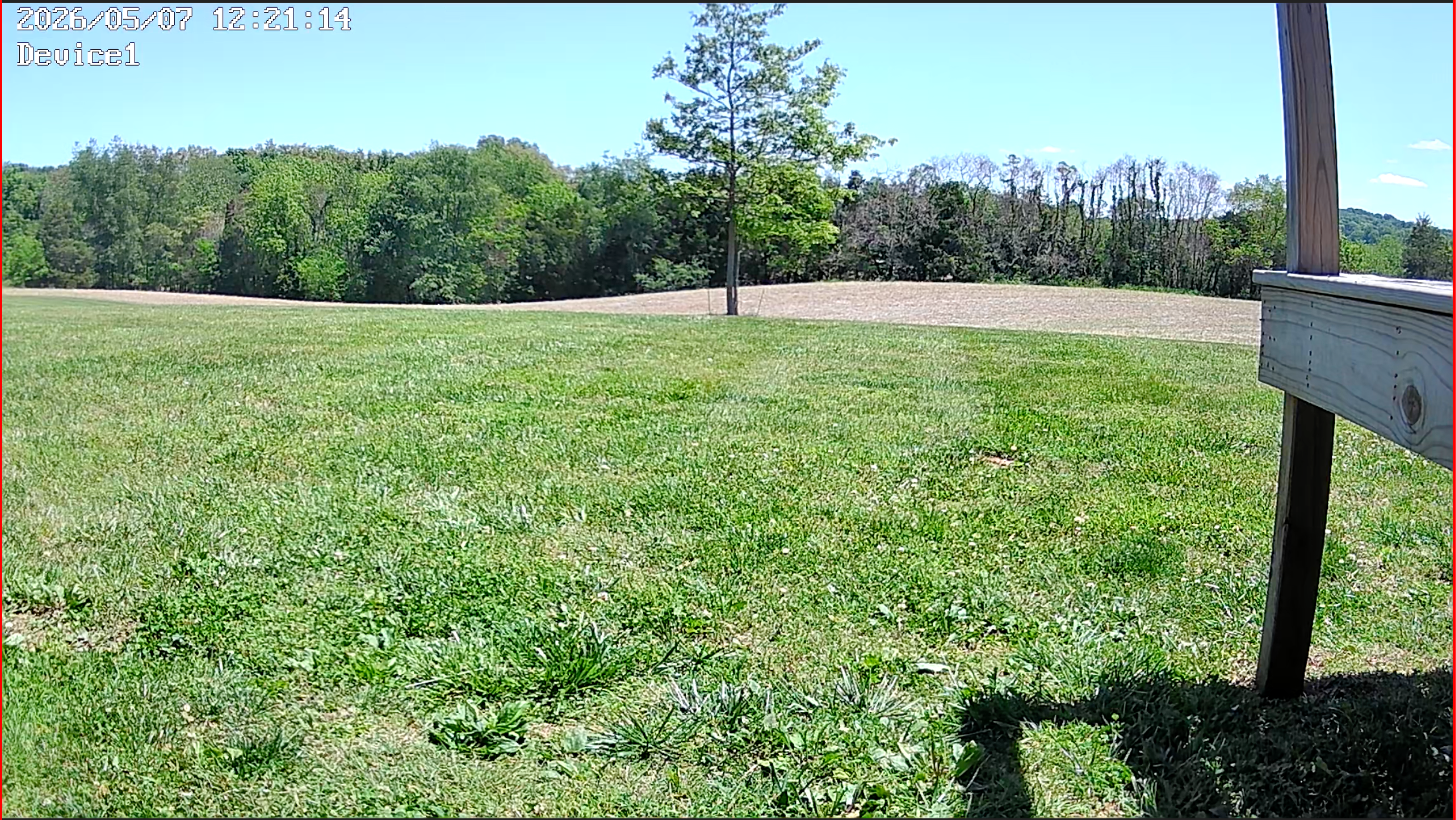

    Upon reading Ovation6's comments, I purchased two of these. All cameras heretofore have been wired, but I tried two of these. The final price after tax was only about $16.90 USD at the time. They work great with SecuritySpy. You can set them up using the ONVIF profile.
    They, unlike many at this price point, have 5 Ghz wifi. The 5 Ghz really keeps a solid connection. The top picture is at our Church building looking off the front porch. The second is looking out across our backyard at home. Both screenshots were taken just a few moments ago on May 7, 2026. The only issue I've run across is recording audio. It simply cuts out the video when I try audio, but that is not needed where I have them. (I'm going to revisit this issue and hopefully get it resolved.)
    Picture # 2 (out the backyard) is located outside and gets a lot of rain and more exposed than the one at the Church building. I thought I would try them, and have been extremely pleased. They work fine for what we need. They might not for you, but for less than $17 each, I thought I would give them a try. I'm glad I did. As you can see, the quality is quite good.
