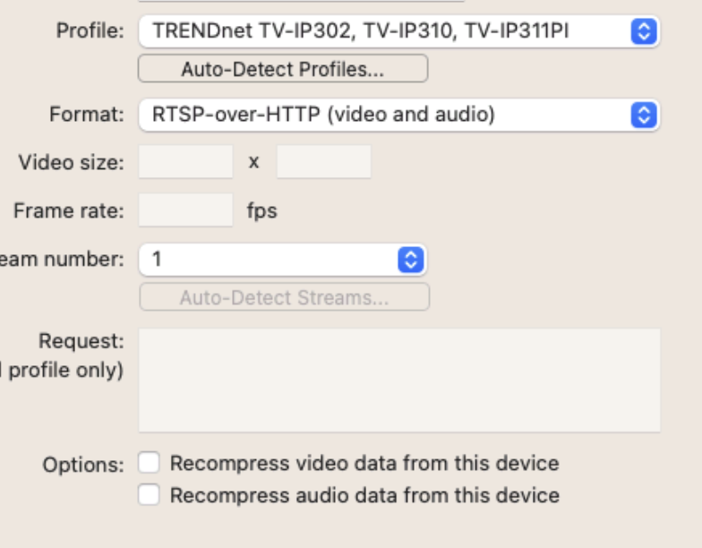

There is no exact profile for the TV-IP312PI. I have 2 of them but they only work intermittently. Trail and error takes quite a bit of time and has simply. Has anyone used a profile with any success? Which one?
The best thing to do is to try all the existing TRENDnet profiles until you find one that works. Also, you could try the ONVIF profile too. Once you find one that works, if it's then inconsistent then a likely culprit of this is the network, especially if the camera is connected by WiFi. Try instead a wired Ethernet connection via a gigabit Ethernet switch.
I used the Auto Discover and then the above profile for mine.
