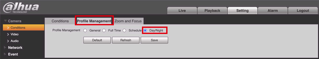

Note that by default the Dahua cameras should be set to switch between day/night profiles automatically based on ambient light levels - is this not working well for you?
I just got the camera installed and I'm playing with the settings and didn't see anything right away with that option.
The Dahua profile controls are far from intuitive, but I believe these are the settings required for automatic day/night switching:
