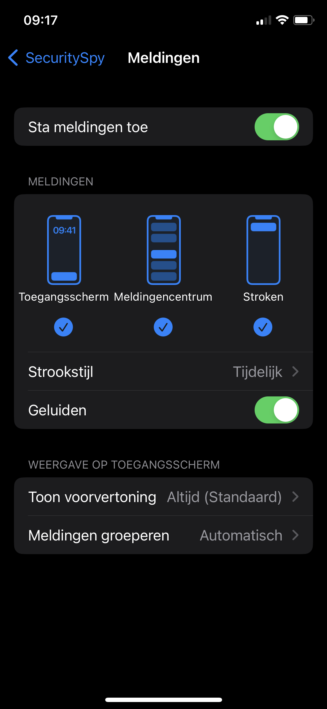

  • Whether a sound is played on the iPhone when a notification is received is determined by the settings on the device in question.
    In the Settings app on your iPhone, scroll down to SecuritySpy and check its Notification settings. Make sure that the "Sounds" option is turned on.
    The other things that determine notification delivery are the switch on the side of the phone (no sound will be played if this is in the silent position), and the Focus mode ("Do Not Disturb" / Driving" / "Sleep" etc.).
  • On my iPhone the sound option for SecuritySpy is on.
    The switch on the side is not in silent position. And Focus mode is off.
    WhenI lift the phone from the table and the screen is on, then I get a sound notification. When I put it back on the table en the screen is going black then I hear no sound notification.
    What do I wrong?
