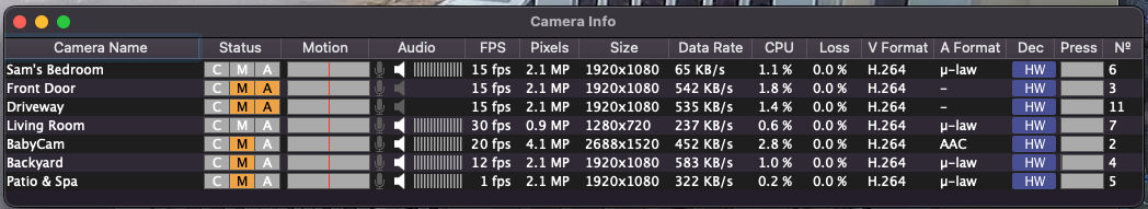

    Assuming so, then this sounds like a video decoding issue. Please can you enable all columns in the Camera Info window (click the header bar where you see the column names to add/remove columns) and then take a screenshot of this window (command-shift-4, space, click on window) and then post the screenshot here.

    Here's what I see in the Camera Info windows for the affected cameras:
    The ones that are problematic are: Front Door, Driveway, Backyard, and Patio & Spa. Happy to try adjusting any settings you think might help!
  • Nothing obviously looks wrong here. Could you please generate and email us a debug file (SecuritySpy menu > Debug > Create Debug File On Desktop) and we will look into this further for you.
