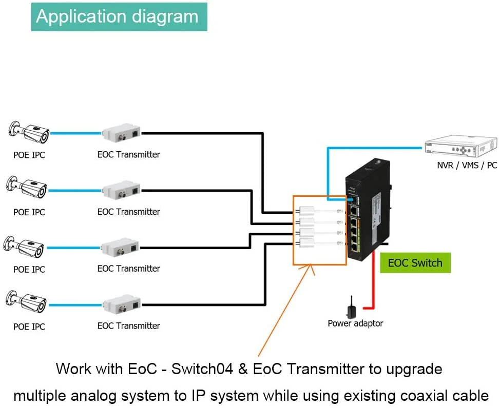

    A few options:

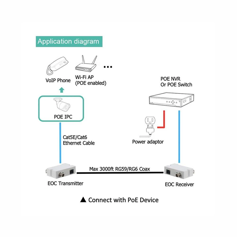

    1. Get an EOC-Converter transmitter + receiver pair for each camera ($75 per pair). The transmitter plugs into the camera and the receiver plugs into a standard PoE switch (e.g. Netgear, TP-Link etc.).
    2. Get an EOC-Switch24 switch ($400). For each camera, you will need a passive adapter ($9) and active transmitter ($44). You can use any standard PoE IP camera.

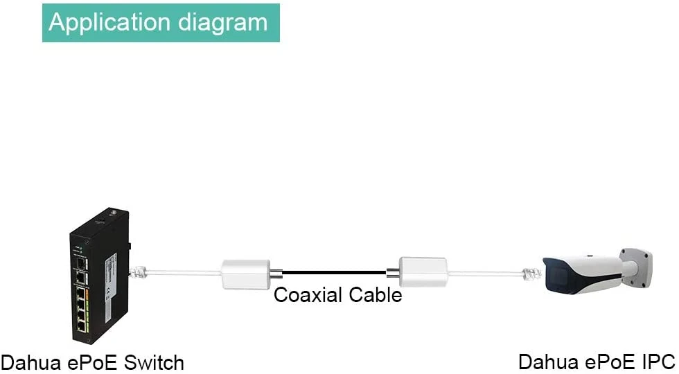

    3. Get an EOC-Switch24 ($400) or a Dahua ePoE switch ($300 for the 8-port version), and use a pair of passive Linovision or Dahua adapters ($18 per pair) for each camera. You must specifically use Dahua ePoE IP cameras for this to work - no other IP camera.

    The above options can be summarised by these images from Linovision:
