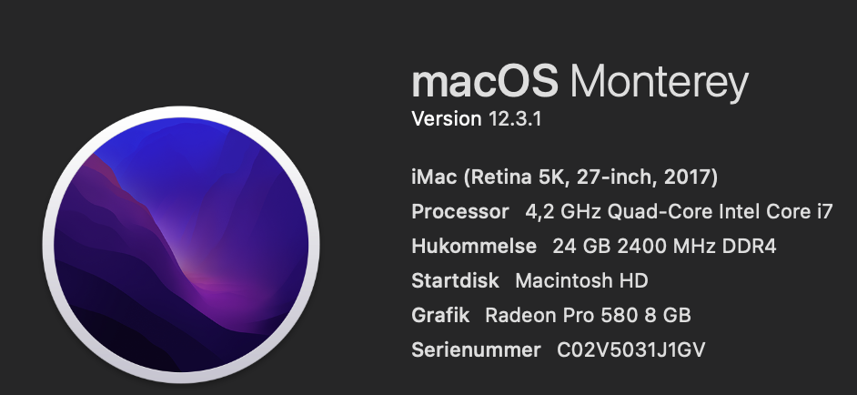

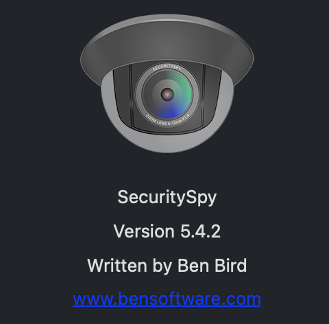

  • Hello This issue is still relevant.
    I got iMac 5K 2017 spec out.
    I have been using securityspy for quite some time now 1+ year.
    but after recent updates this issue is causing CPU to go crazy
    so fan spin up.
    so when I quit security spy it is all back to normal again. so something is wrong with this.
    I only have 2 cameras connected at the moment.
  • Hi @koburg that CPU usage is surprisingly high for just two cameras, but it's difficult to tell from the information you have provided what could be the cause. So that we can investigate this, please email us at support@bensoftware.com and include a debug file (SecuritySpy menu > Debug > Create Debug File On Desktop). We will then help you with this issue directly. Thanks.
  • Thanks sent
    case 55561
