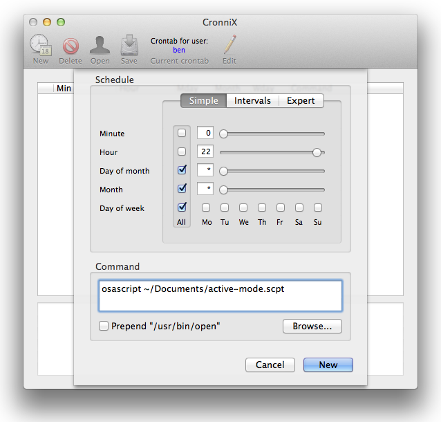

    Then download Cronnix, which is a graphical interfaced for the powerful Unix scheduling feature cron. Open CronniX and set up the script to the called at 10pm every night, like this:
    Then click the New button and then the Save option at the top of the window. The script will then be called at 10pm every night, setting all the cameras to Active mode.
