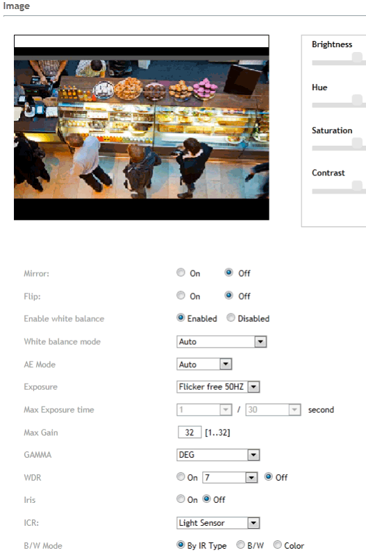

What you are referring to is dynamic range, and some cameras have better dynamic range than others. Many will state "WDS" (Wide Dynamic Range) in their specifications, which would improve the image in the situation you describe.
According to the camera's user manual, under the Camera->Image settings, there's an option there to turn on WDR (see screenshot below). Try this, and also make sure that the "Iris" setting is on:
