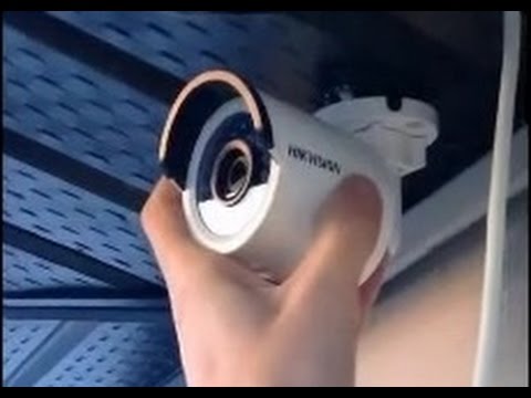

    I have however installed several dome and bullet cameras. Here are a couple videos which might help:
    Bullet Installation and setup:
    See the inside of a dome camera on this dome Install video:
    There are also several videos on my channel on setting up the motion detection and samples of daytime and night vision footage.
