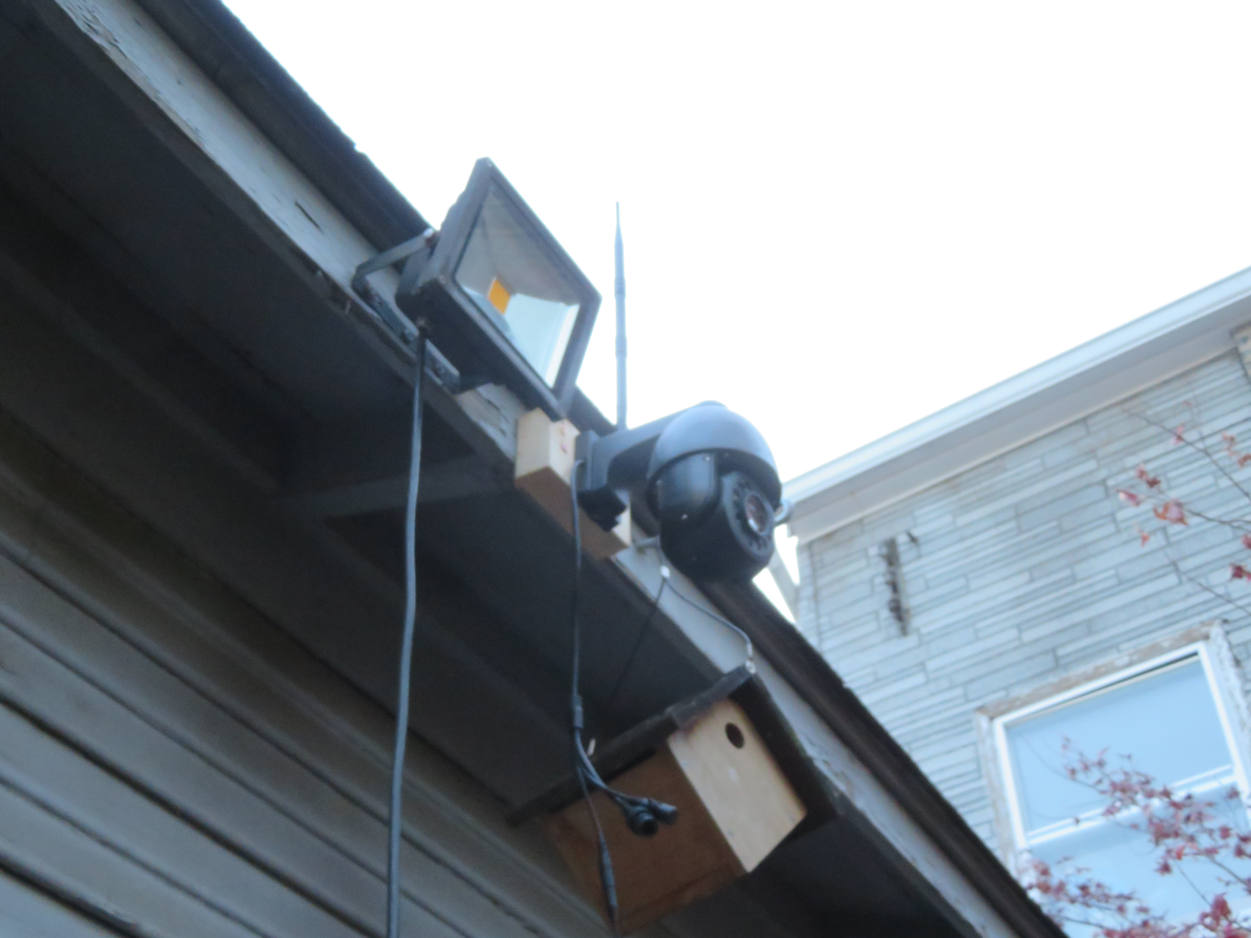

I'm still chugging along on a cheap Asus router that must be 10 years old (Asus RT-12) .... current problem is that my IP cameras that are in the back porch and out in the yard can't reliably connect.... just had to install a new one on the front of the garage and the only way the signal makes it all the way is if I run a router antenna on an extension from the router into the bathroom, through the tub and out the window.

    Thanks for the detailed response! I've been wading through routers and somehow I missed the whole "mesh router" thing until now but they seem to be everywhere. Is there an advantage to a mesh router over using range extenders? I had to go to target tonight and picked up one of these to try: https://www.target.com/p/tp-link-ac750-wi-fi-range-extender-black-re205/-/A-53300569 It didn't help the camera in question when placed in aforementioned bathroom, but I put it elsewhere and now my back porch camera connects reliably instead of sporadically.

  • Router seems to be up and running, all cameras communicating well; also picked up a cheap TPlink range extender, got the "far" cameras using it. Total expenditure between router and extender = $45. Thanks again for all your help!

  • Yes, good advice. I have one of those, several oversized wifi antennae, and also recently bought a entender cable and was experimenting with various placements but it wasn't enough to get things working well. I haven't given a very complete picture of my setup but in order to extend the camera's antenna reasonably closer to the router I'd have to string an extension cable from the garage across the yard up to a second story window... and the nature of the windowframe makes it impossible to close the window if there's a cable in the way. The first thing I did though was swap the camera's stock antenna for an oversized one I have.
