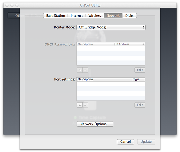

    What you want ideally is two WiFi networks on the same subnet, so that all your devices can communicate with all other devices, and all have access to the internet. To achieve this, both your AirPort devices must be connected by wired ethernet to your switch, and both must be set to Bridge Mode, so that they act as WiFi access points rather than routers themselves. The only router running on your network should be the MicroTik one providing access to the internet.
    To set them to bridge mode, log on to the AirPort using AirPort Utility, click on the Network option, and under "Router Mode", select "Off (Bridge Mode)":
    Under the Wireless option, you need to select "Create a wireless network" as the Network Mode:
    Now assign the cameras and recording Mac to one WiFi network, and all other devices to the other. All your devices will be on the same LAN and same subnet, but the traffic from the cameras on one WiFi network won't be slowing down the other.

    Just to clarify, your MikroTik router should absolutely not be in bridge mode; it's the AirPort devices that should be in bridge mode.
    Consider the TP-Link switch as the central point of your network, to which all other wired devices should connect to. Connect the Mac, MikroTik, and any wired cameras to the TP-Link switch. If you don't have enough ports on the switch, you can instead use any additional LAN ports on the MikroTik, though these aren't likely to be as high-performance as the TP-Link so this should be avoided if possible.
    Both AirPort devices should be in bridge mode, as per my above screenshots. Each should create its own WiFi network. Any general-purpose wireless traffic should connect to one of these, and any wireless cameras should connect to the other one.
