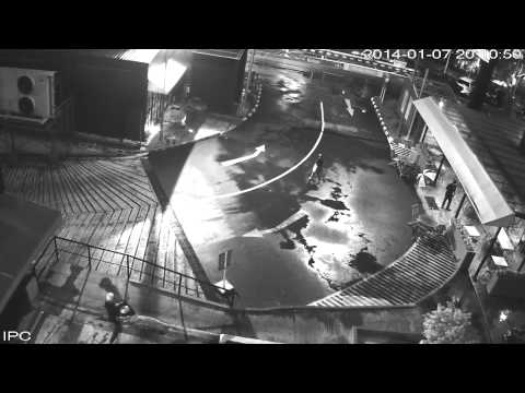

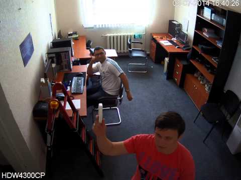

    The Dahua IPC-HDW4300C doesn’t seem to have this problem at all:
    https://youtu.be/gb50YRXnAvs

    The Dahua IPC-HDW4300C has much better low-light sensitivity, so it is able to maintain short exposure times even in low-light situations. Plus, it does have a setting that allows you to manually specify the exposure time.

  • What do you think of the Dahua IPC HDW4300S?
    Image quality looks fine to me.
    https://youtu.be/Tx4JjbgkWD0
  • Hi Robert, the IPC-HDW4300S is very similar to the IPC-HDW3400C (main difference with the S is lack of audio and a different form factor). So if this one is available to you at a good price from a reputable seller, and you don't need audio, then I think it would be a good option.
